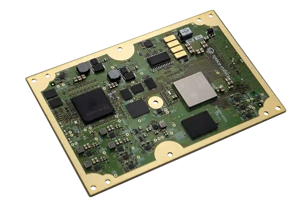

This section describes the software for the SC-OBC Module V1 and how it is organized across the device’s heterogeneous compute resources. Because the module includes multiple processor classes, each has its own section and build, boot, and validation guidance.
